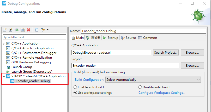

2020-01-30 12:04 AM
I found the problem.
If you run the debug, you should check your debug configuration and use "STM32 Cortex-M C/C++ Application".
