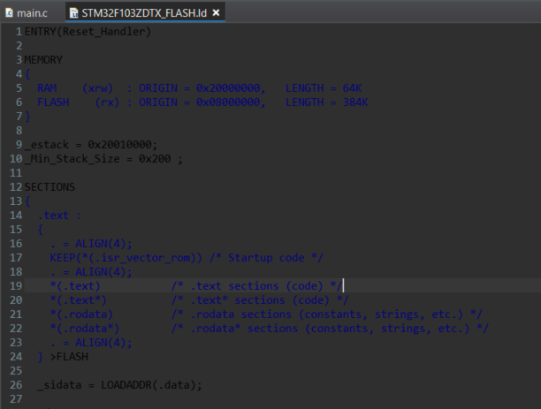

I don't find any options to change the font color for some files like linker scripts (for C/C++ Files it's ok). It's very difficult to read the file and i would like to use the dark theme.

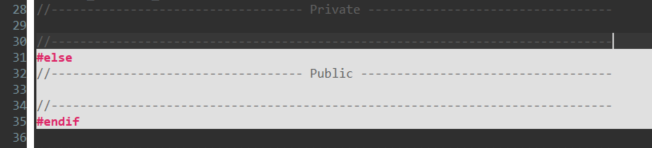

Same thing for not included code :

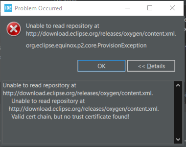

2021-12-15 3:49 AM
Thank you @Peter BENSCH !!!
I work behind a proxy which doesn't allow me to access this url.
I'm able to use offline installer.
Do you know an other way to install this kind of modules ? Thank's
2021-12-15 4:57 AM
A proxy shouldn't be a problem if you enter the proxy data under Window > Preferences > General > Network Connections: host, port, authentication (login, pwd).
In addition, you can set the active provider to e.g. Native and see if you can install Oxygen/DevStyle.
No, I don't know of any offline installer for this, but maybe someone on the Eclipse forums does.

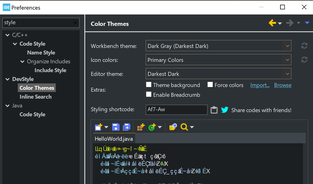

2021-12-15 6:06 AM
I use Dark Gray (Darkest Dark) and it shows up pretty well with the exception of comments in linker files.
