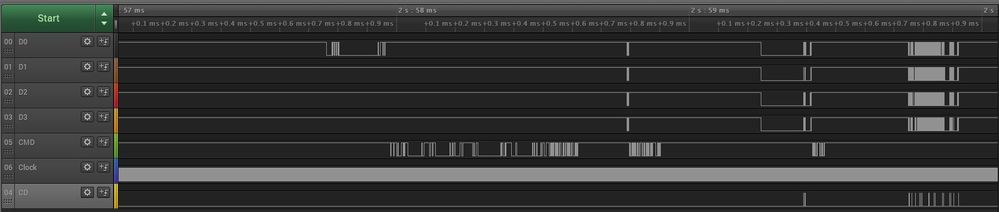

Looking at the logic analyzer from test on the old project this is the expected communication protocol

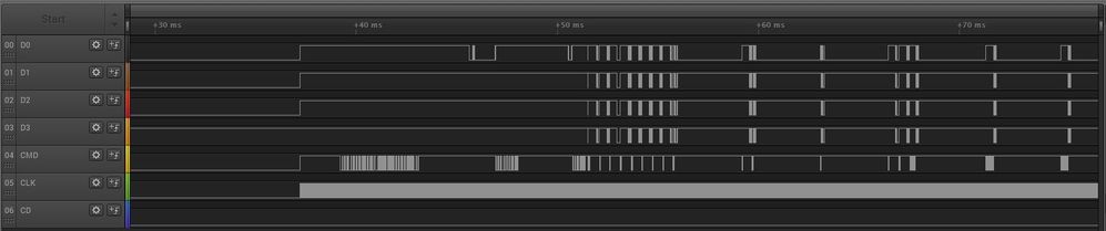

Currently I am now seeing this communication
It seemed odd to me to see so much movement on the card detect line.
There are currently internal pullups (through the CubeMX) on each of the data lines and the Card Detect line.
2021-12-14 9:21 AM
Ended up being a signal integrity issue. Changing Pull-Ups from internal in CubeMX to external Pull-Ups on my circuit fixed the issue.
