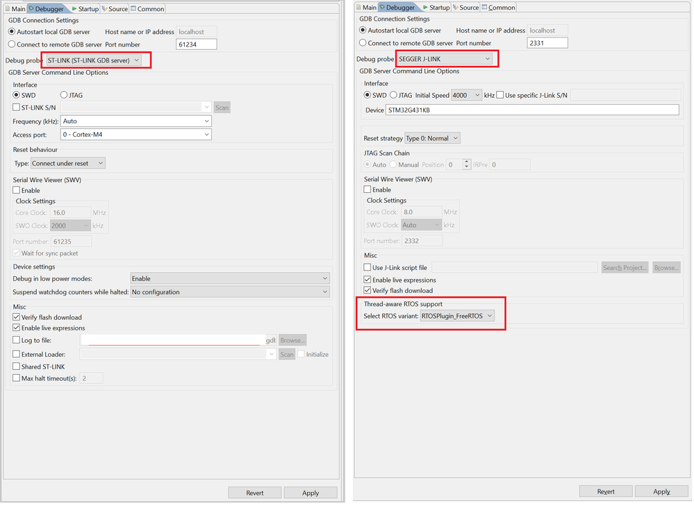

2020-12-22 5:10 AM
Difference for debugger config:
This is STM32CubeIDE
Version: 1.5.1
Build: 9029_20201210_1234 (UTC)
As for Startup - I was asking about sentence on page 119:
When [Thread-aware RTOS support] is used, update the Startup tab: disable [Resume] and [in Run Commands], add thread 2 and continue. This forces a thread context switch before the continue command is sent.
2020-12-22 7:00 AM
I see. The left screen shot does not show the drop-down list because the other (SEGGER) RTOS seems not to be supported, so there is no choice. FreeRTOS views work anyway.
The second point concerns the the Startup tab for the debugger configuration. Didn't work for me (ST-LINK). There are blogs about multi-threaded support for gdb + OpenOCD, see here: https://mcuoneclipse.com/2016/04/09/freertos-thread-debugging-with-eclipse-and-openocd/. I'm not using it however.
