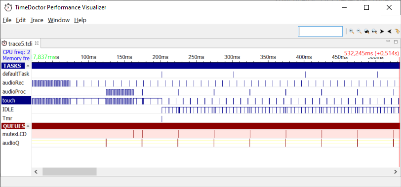

Yes, its basic support. Wish I could walk the stacks of individual tasks or set focus on a task.
If you need more real-time insights; I have ported an ancient tool, TimeDoctor, to M4 and friends:
