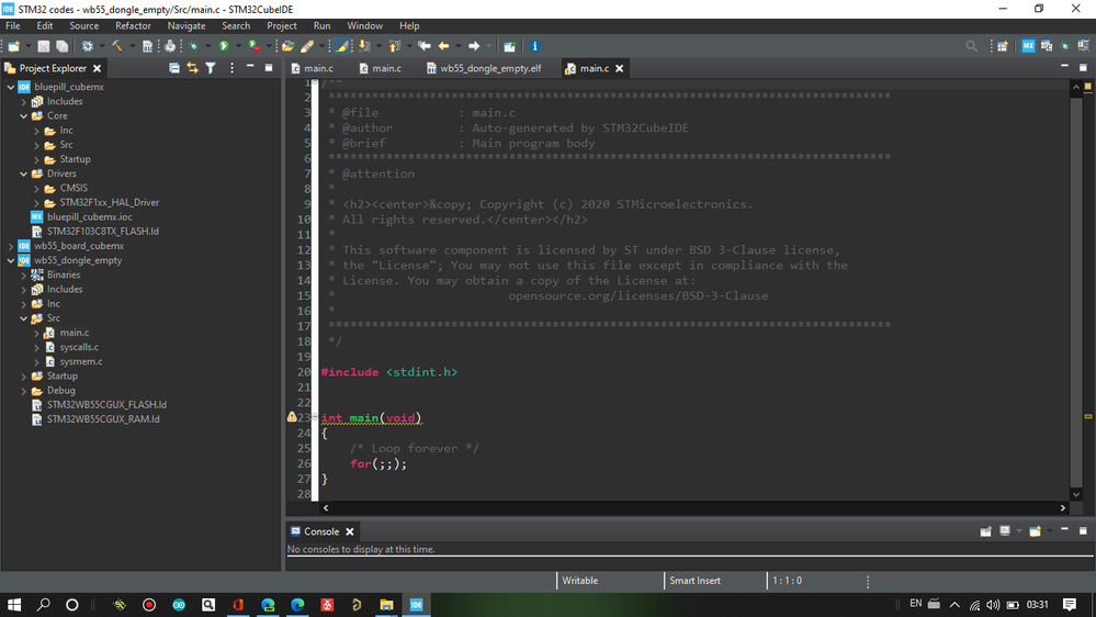

2020-12-22 4:38 AM
Okay, So like I Just create an empty project and include all the required header files( what I think only: peripheral register memory map) to start with embedded c.

2020-12-22 8:25 AM
Yes, you will need to included the header files you want to use. You can study corresponding c files in the FW packages. The name of the header, c-file corresponds to the peripheral names. You can also study different example projects in the FW packages for the devices you are using to get an understanding on how to use the peripheral drivers or just use the ST FW drivers as starting point when creating own drivers. STM32CubeFW packages also normally includes some documentation.
You will probably also need to study the specific STM32 device hardware manual deeply if you are going to develop your own device drivers.
