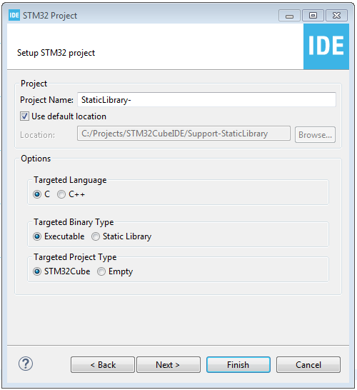

Created STM32 Executable project as follow (Targeted Project Type: STM32Cube):
And configure the device as needed, it runs great without any issues.

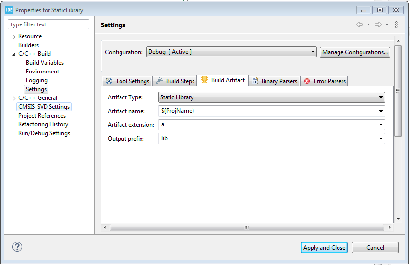

Now I wanted this project to be static library so I can use it as base to other projects, I changed the Build Artifact from Executable to Static Library as follow:

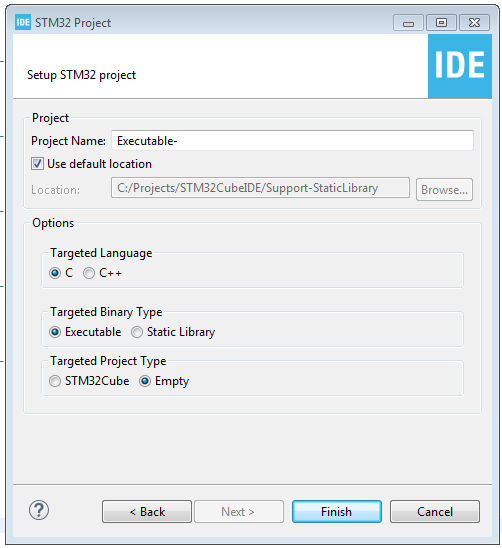

Then I created new STM32 Executable project as follow (Targeted Project Type: Empty):
and linked it with the static library of the first project.
