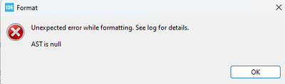

Now, for some reason when I select the directory and perform Source->Format, I get an error:
BTW, do you know where the CubeIDE log is kept?
I tried it a couple of times, and same error appeared.
2025-02-19 8:26 AM - edited 2025-02-19 8:26 AM
Reload CubeIDE and try again. Probably it is a transient error.
The log file is at:
<workspace_location>/.metadata/.ide.log
