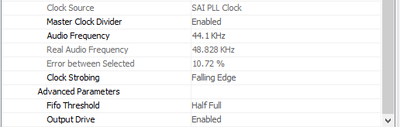

in Cube:
then start it, from now its continuously running... (Check with scope the signal, word clk...to prove your setting.)

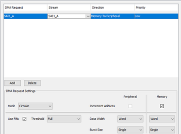

fresult = HAL_DMA_Init(&hdma_sai1_a);
fresult = HAL_SAI_Transmit_DMA(&hsai_BlockA1, (uint8_t *)playbuf , (sizeof(playbuf))/4);// SAI start
(playbuf is int32_t here, because i use 32b sample format, so you might adjust for int16 )
Then just feed it in half/full callbacks - thats it, to get it running. :)

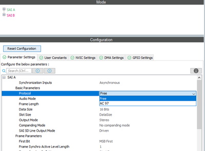

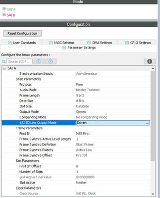

And I think it would be an good idea, to upload my SAI config:

1. SAI DMA data with : word + word ? (32b) -> half-word + half-word (16b)
2. SAI parameters : data size : 8 bit ??? -> 16 bit
+ protocol : free ?? -> I2S standard
+ frame : 8b ???? -> (stereo) -> 32 b (or 2 slot , whatever it shows you for I2S )
Then check with a scope : all signals ok, as should it be .

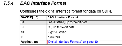

Your CSxxx dac is ..? + set to I2S , 16b stereo , right ?

So, I changed everything you mentioned, but I have some issues with the protocol i only have Free and AC97 . I am not using I²S. What do you mean by "Your csxxx DAC"? If you mean the chip on the board, it's the CS43L22.

Yes , CS43L22 .
> I am not using I²S.
Why ? just set it to I2S , also SAI - and it should work.

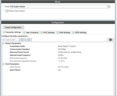

I can't choose the I2S standard for the SAI protocol. Maybe there is something wrong with my I2S configuration?
I2S:

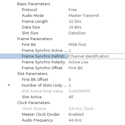

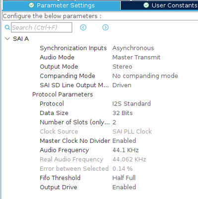

Ok...i see, on F4xxx , seems no I2S preset :) (what a mess ... I only use H743 and H563 for this, they have it.)
so we try free :
