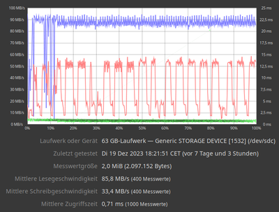

Maybe i got a bad, bad example (have only one of this cards) here, but i tested with speed test on linux and see:
so it can read at 90MB, but sometimes --- bad dropouts.

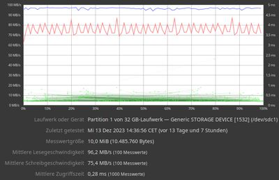

Compare a SanDisk extreme , 32GB :
THIS card reads at 96MB/s -- always.
I think, this is a very important difference, showing a little the "internal" quality of the flash area.
Also the write performance is very different: the Kingston card writing at 50 or 5 (!) MB, alternately (!) ,
the SanDisk at 80 or 70 MB .... rate the drama yourself.
