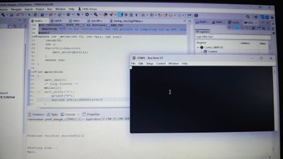

I'm trying retarget printf. My uart_write function is working correctly and i'm able to see character on Teraterm.
But when i try to use printf it is not working. i even tried semihosting to execute printf but it fails. i'm attaching the screenshots -
Disassembly of the code stucks at "bkpt 0x00ab" -
any solution for this problem?

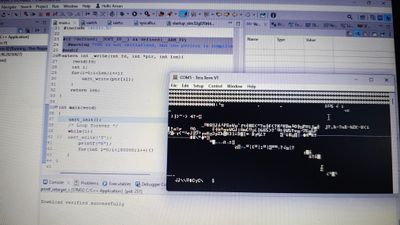

Tried with the C project as well it's not working.
It printed few lines then threw some garbage. I retried debugging but now nothing displayed on terminal.
Do I need to increase baud rate from 9600 to 115200? Because it's taking time to print.
