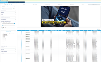

I'm trying to understand what filters I have to apply in CubeMX to find products that support 2 QUADSPI with independent clock. E.g. h7a3aii6q seems to be such part that allows me to have two independent QUADSPI and there are parts like e.g. H743XIH6 that have QUADSPI Dual-Bank with two NCS but with only 1 Clock and there are also Parts with OCTOSPI, but they don't seem to have two independent interfaces most of them time.
Any chance to make part search easier for me to find products that have features like these two independent QUADSPI?
Thx

The screenshot shows that CubeMX allows you to filter for MCUs with two QUADSPI interfaces and external memory options, but it does not distinguish between devices with two fully independent QUADSPI peripherals and those with a single QUADSPI supporting dual-bank (two chip selects, one clock). As a result, the filtered list may include both types. To ensure you select a device with two truly independent QUADSPI modules, you must check the datasheet
