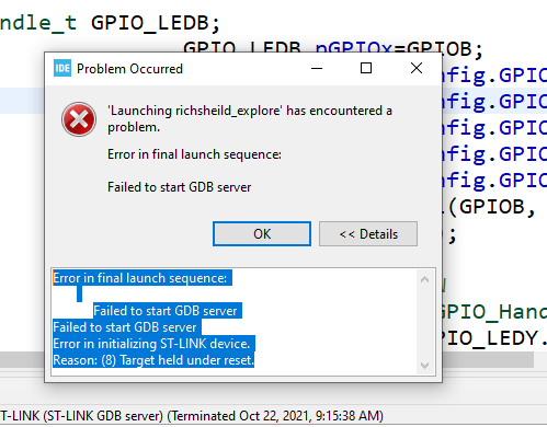

When i am trying to debug i am facing issues like "Error in final launch sequence:Failed to start GDB server"
Please let me know if anyone is aware of how to solve this issue

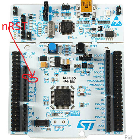

"Target held under reset." Check NRST signal and what is keeping it low.

It looks like your richsheild is keeping the nRST pin low, sometimes this error also happens to me sometimes if not enough power is reaching the stm32 chip
