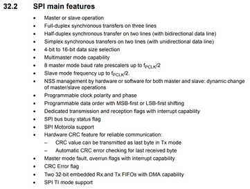

Hello @rubenles ,
According to Reference manual, SPI supports many standards like as Motorola standard and TI mode standard.
SPI Motorola mode is selected by default after a device reset. For more information about the SPI protocol, I recommend you take a look at Guidelines for enhanced SPI communication on STM32 MCUs and MPUs application note.
Thank you.
Kaouthar

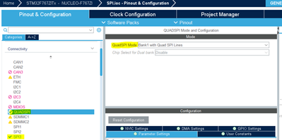

Hello @rubenles
The SPI and the QUADSPI are two different interfaces:
In this code you configure the SPI3 instance as master mode.
hspi3.Instance = SPI3;
hspi3.Init.Mode = SPI_MODE_MASTER;
The STM32CubeMX can help you to configure the other modes.
Also, I recommend you to take a look at the device reference manual and precisely SPI and QUADSPI sections and at AN4760 application note.
I hope this answer your request.
Thank you.
Kaouthar

Hello @rubenles ,
Thank you.
Kaouthar
