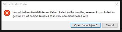

but when I click Run and Debug, and choose st-link gdb, the result is as below
a small box shows" gdb is not running.
so what is the matter?

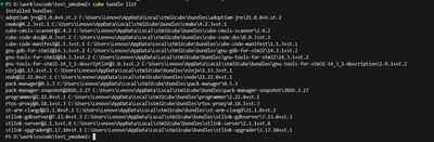

@dqsh06
what the following is reporting from a VS Code integrated terminal ? (https://community.st.com/t5/stm32cubeide-for-visual-studio/unable-to-install-stlink-gdbserver-with-bundles-manager/td-p/885884)
cube stlink-gdbserver --version what about ? (https://community.st.com/t5/stm32cubeide-for-visual-studio/bundles-manager-takes-very-long-time-to-load/td-p/885601)
cube bundle list-online
cube bundle list

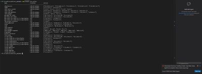

2026-03-16 1:30 AM
as below:

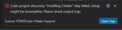

[cmake] -- Check for working C compiler: C:/Users/Lenovo/AppData/Local/stm32cube/bundles/gnu-tools-for-stm32/14.3.1+st.2/bin/arm-none-eabi-gcc.exe - skippedthe problem is every time I openned the vscode i got a popup box as below
it said installing CMake step failed. but actually, I have installed the stm32cube/bundles/cmake/4.2.3+st.1

2026-03-17 09:19:25.024 [Warn] Active project is not STM32Cube ready, not applying STM32Cube configurationit said "Failed to list bundles", I don't know what is this means.
so what is wrong?
Thanks.

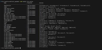

@dqsh06
Are you able to reach remote bundles server ?
cube bundle list-onlineYou need to be online to get the stuff works see https://community.st.com/t5/stm32cubeide-for-visual-studio/connectivity-issues-of-stm32cubeide-for-vscode/m-p/862035#M1583
Any trace as part of STM32Cube core output channel ? Any spurious stuff looking at devtools console ?
2026-03-17 6:31 PM
yes, I can reach remote bundles server. as below, but still indicated "installing CMake" step failed.
the log is
I don't know why it is, maybe this is a bug of stm32cubeide for vscode. it is very diffcult to use this version of stm32cubeide for vscode.
