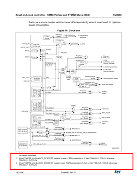

I'm working with a STM32F439ZI and want to use the PWM outputs of timer3 & timer4. I want to set a frequency of 50Hz (m_dat.fI) as an example. If I calculate it with the formula below, it results in a frequency of 100Hz instead and I'm not sure why, can someone help out?
PSC is set to 27 for both timers. and PCLK1 is at 42MHz
PCLK1Freq = HAL_RCC_GetPCLK1Freq();
TIM3->ARR = (uint32_t)(((double)PCLK1Freq / (double)m_dat.fI) / ((double)TIM3->PSC + 1)) - 1;
TIM4->ARR = (uint32_t)(((double)PCLK1Freq / (double)m_dat.fI) / ((double)TIM4->PSC + 1)) - 1;

The divider is BYPASSED to allow higher clocking speeds on the slower bus. New STM32 families also allow the clock to come from different internal sources.
