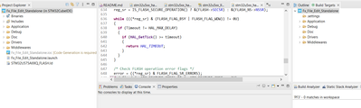

do search for PF3 , it is defined somewhere and change to PD5
I searched the whole project, but no PF3 string found.

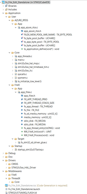

Does anyone use Fx_File_Edit_Standalone example as baseline for file system? This works for another version of Eval board, but with NUCLEO-U575ZI board, I have to change SDIO DETECT   to PD5 from PF3.
Thanks in advance.
