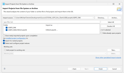

This issue has regressed. I am not able to import projects that I just set up with CubeMX. Here are the steps:
1. Open CubeMX, enter my board, click on an example, set the path and save it.
2. Open STM32CubeIDE, opening the parent folder of the project. Choose import, select the folder the project is in, it successfully finds the project so then I click Finish3.
3. Then, nothing! No error, and no projects added to the workspace.
