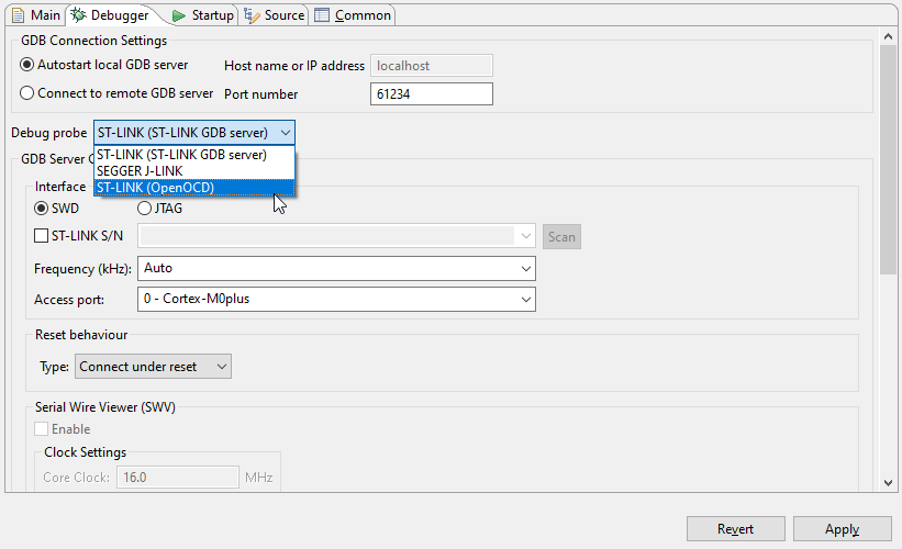

2021-04-27 3:28 AM
I also had a similar problem, Nucleo board with ST-LINK/V2, STM32CubeIDE 1.6. on Windows 10.
I notived that I also get "Warning: the current language does not match this frame." in the Debugger Console.
I found a link https://gcc-renesas.com/question/fix-warning-current-language-match-frame/ which is not online anymore, but the online search cache preserved "This seems to be an error caused by the inability to connect to port 61234 on your machine, port which is usually opened when the GDB server is ..." Also, https://stackoverflow.com/questions/27818914/eclipse-cannot-set-a-breakpoint-while-debbuging-arm mentions an old bug in Eclipse.
Ultimately, this motivated me to try:
> I've had to switch to using OpenOCD mode of the debugger to get around this problem for now.
This is the change that I did in the UI:
Now breakpoints hit where they should upon Run > Debug - but ironically, I still get "Warning: the current language does not match this frame." in the Debugger Console.
