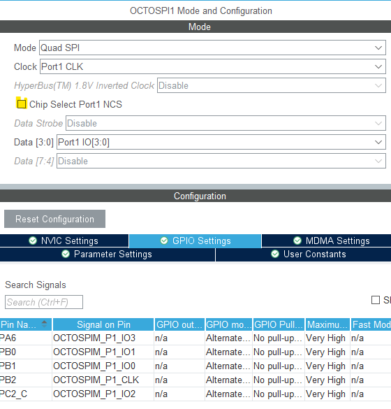

preconditions:
The idea is to have multiple QSPI chips connected to the QSPI with their own chip select pin. So the use NCS shall not be provided through the HW. In the Cube GUI the NCS is not selected:

}Of course there:
sOspiManagerCfg.NCSPort = 0;because NCS is not used.
In HAL_OSPIM_Config (stm32h7xx_hal_ospi.c, line: 2484) the following assertion will be hit of course:
assert_param(IS_OSPIM_PORT(cfg->NCSPort));This is wrong in my opinion. Either it is not possible not to use the NCS; then the Cube GUI is wrong as shown in the picture above. Or the generated code is wrong.
What is your opinion about that?
