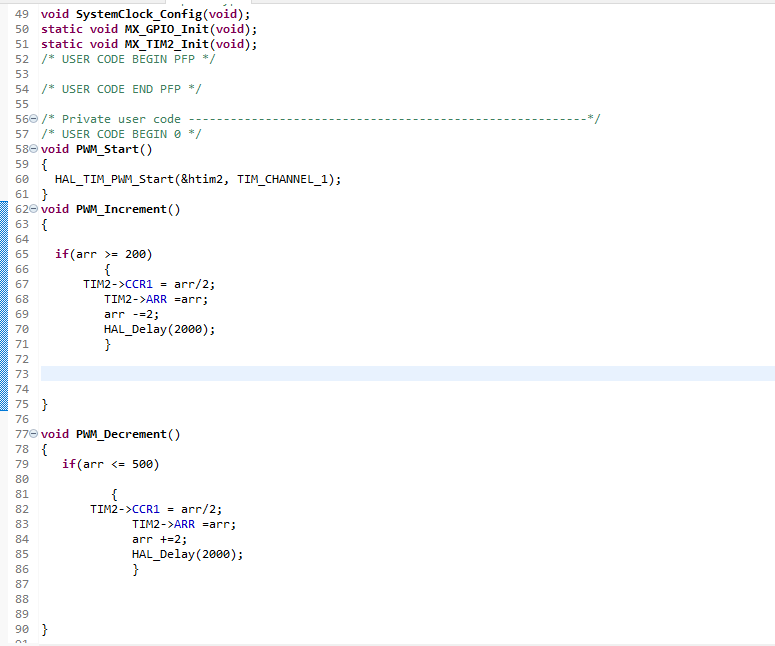

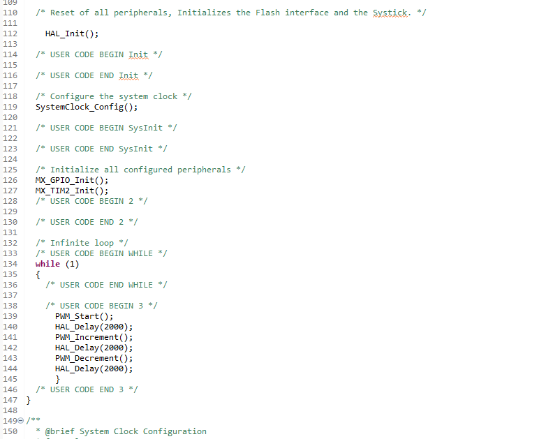

Hii, i am using NUCLEO-G474RE board and i want to generate pwm signal in which frequency change frequently .But i dont know why this code is not working.

First, you need to declare the PWM_start() function before the while(1) (in the main function).
Also, what is the original value of your arr variable.

I have already declare PWM_Start() globally. And the original value of arr is 200 that i mention globally.
