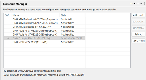

2023-11-03 3:06 AM
STM32CUbeIDE Version: 1.11.0
Build: 13638_20221122_1308 (UTC)
I don't know if this is the compiler toolchain version you asked me. If it is not, tell me where I can find it so I can tell you.
2023-11-03 3:08 AM
@AuthorityThis toolchain version issue are you sure it applies here? Because, as I said, printf works in all my other projects and has never given me any problems with this version .. so maybe there is a technical problem in this project either in the code or incompatibility with the DSP libraries I have installed
2023-11-03 3:23 AM
You'll find this information at;
STM32CubeIDE > Windows > Preferences > STM32Cube > Toolchain Manager.
Try to make the change and see if this solves the issue.
2023-11-03 3:40 AM
