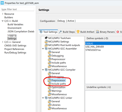

The defines and include directories used during compilation are shown in project properties. Right click on the project to access project properties. You should match those. They are also shown during compilation on the console tab.
If you still run into errors, read those error messages and let that guide what you need to change.

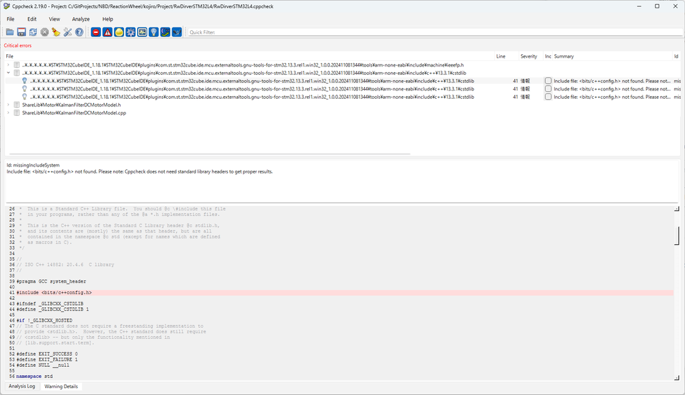

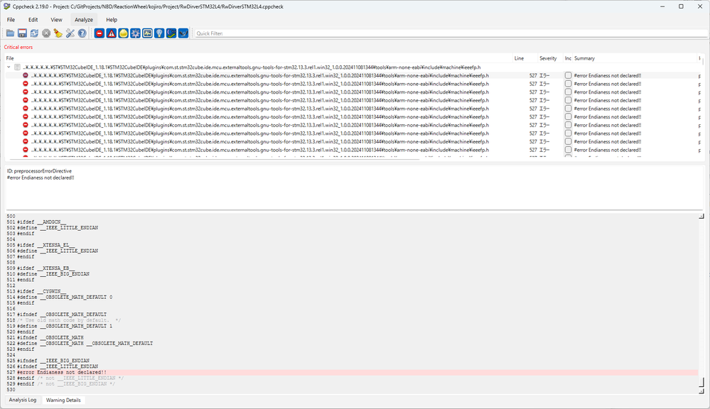

I have already added those.
I have added images of the CppCheck error.
Please look at those photos.
I have already added the following toolchain folders to include Paths.
  • C:\ST\STM32CubeIDE_1.18.1\STM32CubeIDE\plugins\com.st.stm32cube.ide.mcu.externaltools.gnu-tools-for-stm32.13.3.rel1.win32_1.0.0.202411081344\tools\arm-none-eabi\include\
  • C:\ST\STM32CubeIDE_1.18.1\STM32CubeIDE\plugins\com.st.stm32cube.ide.mcu.externaltools.gnu-tools-for-stm32.13.3.rel1.win32_1.0.0.202411081344\tools\arm-none-eabi\include\c++\13.3.1\
  • C:\ST\STM32CubeIDE_1.18.1\STM32CubeIDE\plugins\com.st.stm32cube.ide.mcu.externaltools.gnu-tools-for-stm32.13.3.rel1.win32_1.0.0.202411081344\tools\lib\gcc\arm-none-eabi\13.3.1\include\
These may be incorrect.
I searched for “c++config.h” and tried to add it to the include path, but there are multiple versions depending on the ARM toolchain version, and I wasn’t sure which one I should select.
Do you have any additional advice after looking at the images?
