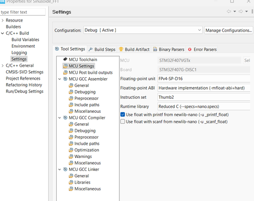

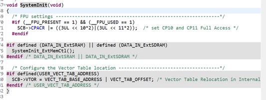

Do you enable the FPU in your SystemInit() code?
Has it linked the appropriate C library. 32-bit ARM code will fault a CM4F processor.

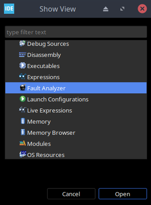

Does the CubeIDE provide some sort of Hard Fault Analyzer function or window?

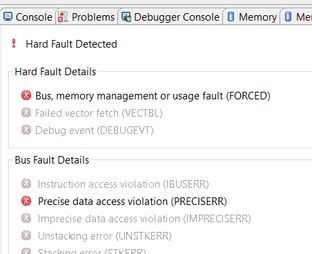

the CubeIDE has many great things (...if they are working...) :
2023-11-02 11:34 AM - edited 2023-11-02 12:29 PM
Now I don't understand if the problem is in the code I wrote (main.c) or in some other file
Thanks @AScha.3 I didn't know about this function because I never needed it

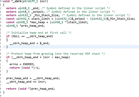

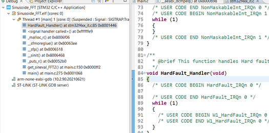

The last thing on the call stack is malloc_r (malloc) so check the pool (size, address....). Where _sbrk() is implemented? Do you have sysmem.c ?
2023-11-02 3:08 PM - edited 2023-11-02 3:10 PM
_sbrk() is in sysmem.c
