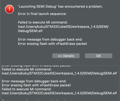

I'm trying out semihosting with openocd in STM32CubeIDE.  For this purpose I added the call
initialise_monitor_handles();
in main.c as the second call after HAL_Init();
I have STLINK(gdb server) configured. The program goes into that call (initialise_monitor_handles) but never returns.
Trying OpenOCD gives another error:

Error: timed out while waiting for target halted
Error executing event gdb-attach on target STM32H503CBTx.cpu:
/Applications/STM32CubeIDE.app/Contents/Eclipse/plugins/com.st.stm32cube.ide.mcu.debug.openocd_2.3.100.202501240831/resources/openocd/st_scripts/gdb_helper.tcl:18: Error: TARGET: STM32H503CBTx.cpu - Not halted
in procedure 'gdb_attach_hook' called at file "/Applications/STM32CubeIDE.app/Contents/Eclipse/plugins/com.st.stm32cube.ide.mcu.debug.openocd_2.3.100.202501240831/resources/openocd/st_scripts/target/stm32h5x.cfg", line 379
in procedure 'first_gdb_attach_hook' called at file "/Applications/STM32CubeIDE.app/Contents/Eclipse/plugins/com.st.stm32cube.ide.mcu.debug.openocd_2.3.100.202501240831/resources/openocd/st_scripts/gdb_helper.tcl", line 18
Info : device idcode = 0x10036474 (STM32H50xx - Rev Y : 0x1003)
Info : Product State = 0xED : 'Open'
Info : flash size = 128kbytes
Info : flash mode : dual-bank
Info : New GDB Connection: 1, Target STM32H503CBTx.cpu, state: running
Warn : GDB connection 1 on target STM32H503CBTx.cpu not halted
undefined debug reason 8 (UNDEFINED) - target needs reset
Error: Failed to read memory at 0x00000000
Info : accepting 'gdb' connection on tcp/3333
Info : New GDB Connection: 2, Target STM32H503CBTx.cpu, state: running
Warn : GDB connection 2 on target STM32H503CBTx.cpu not halted
Error executing event gdb-flash-erase-start on target STM32H503CBTx.cpu:
Error: Target not halted
Error: failed erasing sectors 0 to 2
Error: flash_erase returned -304
Info : dropped 'gdb' connection
shutdown command invoked
