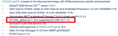

yesterday before i have updated cube ide to version 1.18.0 , after the update qspi external loader stopped working .
Before the update qspi related stldr creation & external loader everything works fine , after the update everything related qspi debugging completely broken down .
Even the https://github.com/cturvey/stm32extldr also stopped working.
I have suspected v2 stlink driver , v2 st link firm ware & cube mx So, i have removed the the stlink driver and version v1.18.0 software and installed the ide version v1.17.0 but still the problem is same how to bring back( downgrade) old st link driver and compatible v2 st link firmware to v1.17.0.
