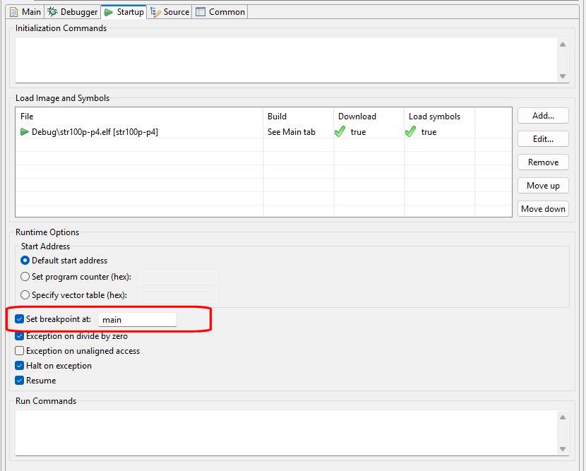

I would recommend to disable the "hidden part" of the debugger.
I'm not a Cube user, but I'm quite sure it has a setting "run to main()" enabled by default.
Disable the setting, and put a breakpoint in the startup code, as early as possible.
I suspect some init code fails, either RAM init, clock setup, or (as probably in your case) setup of the ext. memory interface.

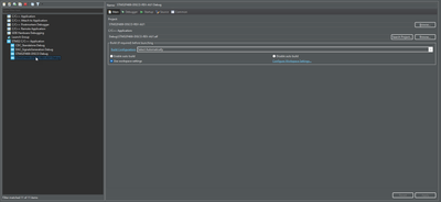

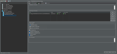

Indeed it does:
In the 'Debug Configuration' settings

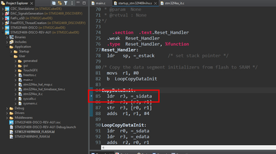

I would set the breakpoint before the "b LoopCopyDataInit".
Or on the first instruction of this loop.
Which is the place where values of initialized variables are copied in (from Flash to RAM).
Those variables usually end up in a separate linker section.
Perhaps you changed something in you project, and something got mixed up which results in RAM beyond this section gets overwritten.
Which would require a cross-check with the map file.
