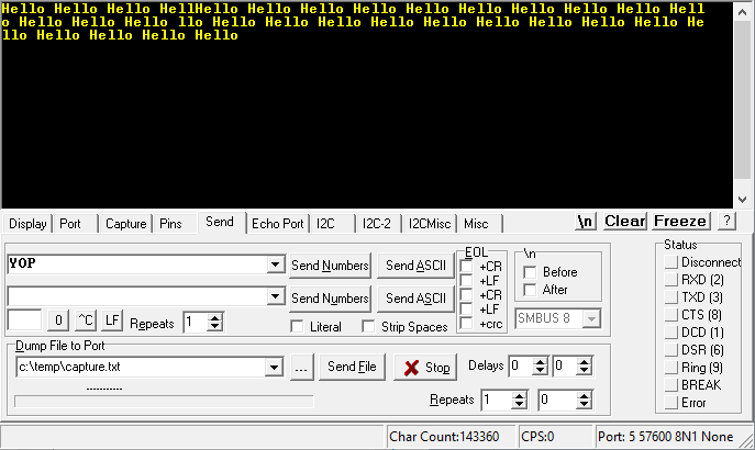

When I use Realterm, I have the following data received by the PC:
When I send data to the MCU with RealTerm (e.g. the string "YOP") :

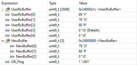

Using the debugger, I suspend the process and watch the data, which have been received:

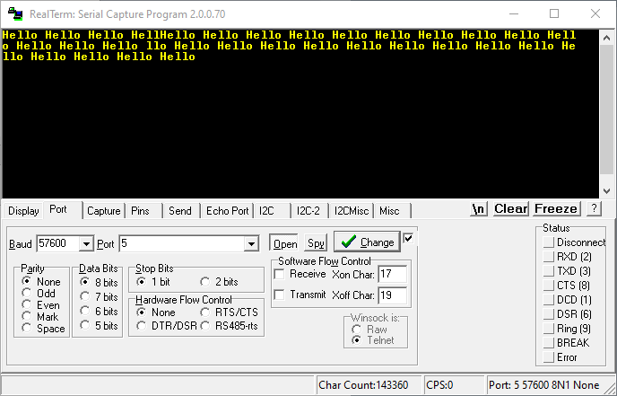

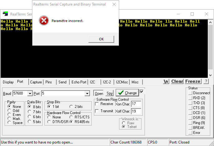

However, as soon as I enable the I2C, I can't communicate with RealTerm anymore (I also tried Putty with the same results).
However, the PC still detect the VCP as it can be seen in the screenshot of the device manager below :
