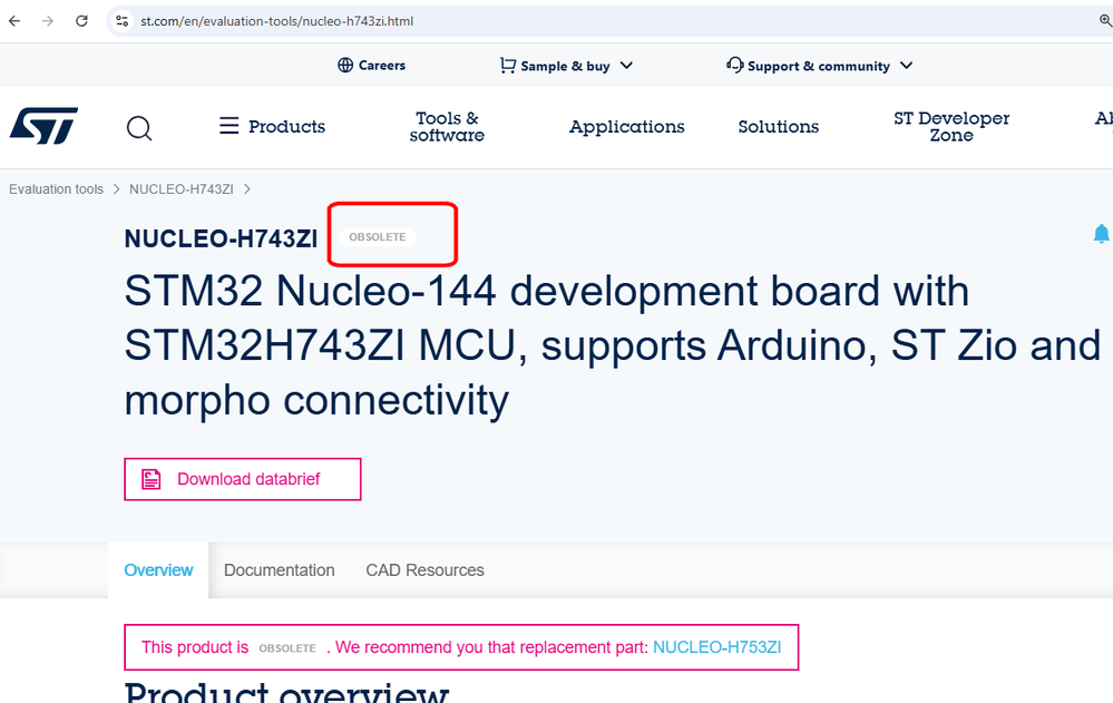

What CubeIDE version are you using?
@ramdev29 wrote:When I try to open an example project, it shows the message: 'Target NUCLEO-H743ZI2 is obsolete
It is correct:

Hello @ramdev29 and welcome to the community
It shows a pop up message indicating it's an obsolete board but the code is well generated.
What is the CubeIDE version you are using?
