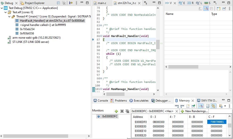

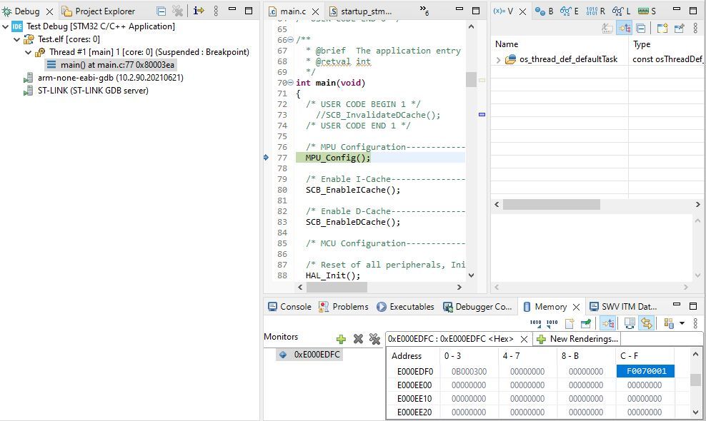

_legacyfs_online_stmicro_images_0693W00000biDDJQA2.pngAt startup, the first image is displayed (the first stop), at further startup it stops at HardFault_Handler (the second image) . I didn't write a single line of my code, I only indicated the use of FreeRTOS, lwIP + CPU DCache.

I mixed up the images in places)

Why do you need to enable DCache? Could you (or the Ethernet peripheral) be trying to DMA data into cached areas in RAM. If so, your code (or the HAL code) needs in invalidate the cache lines before trying to read that data. Can you try running with DCache disabled and see if it changes things.
The addresses in the stack back-trace do not look like valid code space addresses (though I am not entirely familiar with the H7 memory map). It could be that your stack is somehow getting corrupted, messing up function returns. If using an RTOS, double-check your task stack sizes. CubeIDE has a fault analyzer window. That will show you the registers. See if the SP value makes any sense (i.e. does it point to your stack area?).
