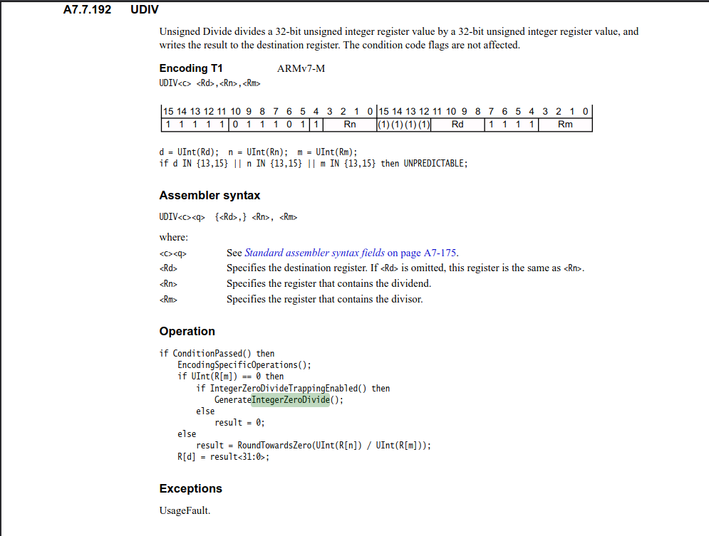

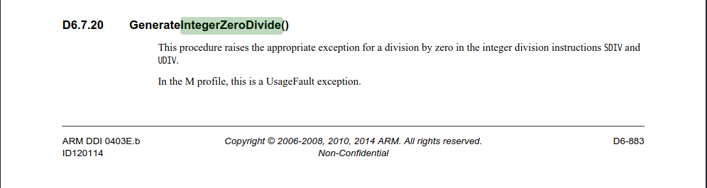

@MvA54 wrote:Here, I’m intentionally dividing a uint8_t value by zero inside the APP_Test_Init function, causing a Hard Fault.When I examine the *.map file, shouldn’t I be able to see the APP_Test_Init function?
Dividing by zero should "normally" generate an usage fault on the ARMv7-M architecture, not a hard fault.
You can read this in the ARMv7-M TRM:UDIV
UsageFault raised by UDIV
Because when I try to divide by zero in C:
int test(unsigned char a)
return a / 0;
}GCC use UDIV for the calculation in the resulting object file:
test.o: file format elf32-littlearm
Disassembly of section .text:
00000000 <test>:
0: b480 push {r7}
2: b083 sub sp, #12
4: af00 add r7, sp, #0
6: 4603 mov r3, r0
8: 71fb strb r3, [r7, #7]
a: 79fb ldrb r3, [r7, #7]
c: 2200 movs r2, #0
e: fbb3 f3f2 udiv r3, r3, r2
12: b2db uxtb r3, r3
14: 4618 mov r0, r3
16: 370c adds r7, #12
18: 46bd mov sp, r7
1a: bc80 pop {r7}
1c: 4770 bx lr
