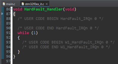

I am trying to connect a SD card and read&write data. I did same things to my STM32F429 but when I tried them on STM32F030C8, I am facing with Debug Current Instruction Point at HardFault_Handler() function in stm32f0xx_it.c file.

Have your Hard Fault Handler output actionable data to identify the code causing the fault. A while() provides no useful information.

If you don't see the call stack deep enough - this can be because the compiler over-optimized HardFault_Handler (and other such handlers there). It sees the while(1), figures out that the function never returns, so there's no need to put the return address on stack. If this is the case - a simple trick can beat the compiler and let you see the stack of HardFault_Handler.
