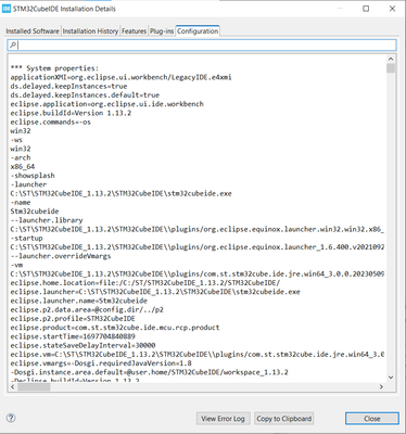

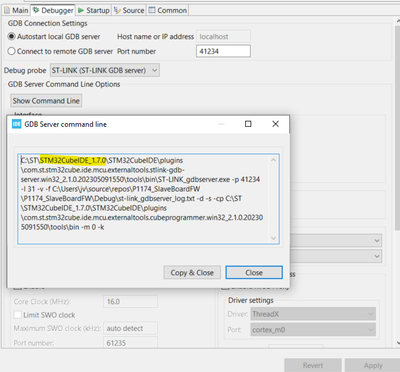

2023-10-19 1:14 AM - edited 2023-10-19 1:37 AM
It's a bit weird that the GDB Server in use seems to be from the previous installation, at least looking at the path used in the Debug configuration.
Looking at the Installation details, it seems like there's a mix between the new and the old installation.

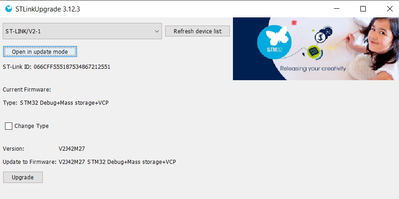

for the STLink can you try to upgrade the STlink from Help>ST-Link Upgrade or verify your cable.
Thank you!
Souhaib

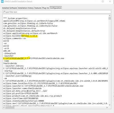

2023-10-19 2:52 AM
Hi Souhaib,
The STLink upgrade works, it detects the St-link which is already at the latest version.
Regarding the mismatch in installation details from my previous reply, that was because I was running the 1.7 IDE (which shows version 1.13.2 and points at all the 1.7 version plugins). Opening version 1.13.2 IDE seems to show the version/paths that I was expecting.
