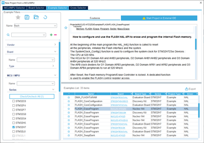

> Any idea where I can find a HAL H7 example to write in the Flash?
Use the Example Selector in CubeMX to find and run relevant examples.
2023-10-18 10:57 AM - edited 2023-10-18 10:57 AM
Might I suggest looking through the repositories locally with a file browser or manager, or on GitHub directly?
