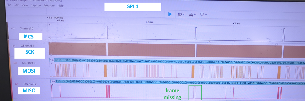

I am herewith attaching the snap shot of logic analyzer (for SPI 1). Similar for SPI2.
TDK
Super User
Apart from MISO, everything looks fine to the extent that I can see. Can't resolve detail around CS edges.

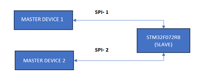

Hi Guru,
In our application STM32 is SPI slave mode, Above is reference block diagram, attached above is SPI-1 and SPI-2 waveforms in previous chat
Kindly guide as on Data transfer From Slave to master (MISO)
We are getting alternate frame miss in MISO as you can see in above waveform snaps in previous chain
As you mentioned CS/SCK/MOSI signal are correct, nothing is wrong on the master side -----> yes
We are facing issue in slave (STM32F072) data transfer to Master device
