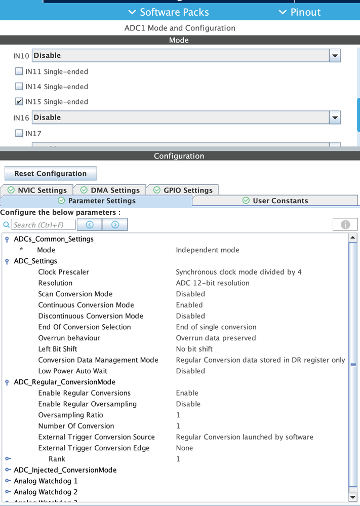

I am trying to read a simple adc with DMA method, but the DMA Continuous Request option is not visible as seen in the screenshot. CubeIDE Version: 18.1, Nucleo h755zi-q. Macbook Pro M4, 2024I am trying to read a simple adc with DMA method, but the DMA Continuous Request option is not visible as seen in the screenshot. CubeIDE Version: 18.1, Nucleo h755zi-q. Macbook Pro M4, 2024
I am trying to read a simple adc with DMA method, but the DMA Continuous Request option is not visible as seen in the screenshot. Even though I added from the DMA window, the problem persists. CubeIDE Version: 18.1, Nucleo h755zi-q. Macbook Pro M4 Pro, 2024.

There is no such setting on the STM32H755 and it is not required for ADC/DMA to work correctly.
Set up the ADC and DMA and start the conversion with HAL_ADC_Start_DMA and it'll work.
https://github.com/STMicroelectronics/STM32CubeH7/tree/bf1cd36e9d5cdcecddbb6745cd43ac6f1fa27bb1/Projects/NUCLEO-H743ZI/Examples/ADC/ADC_DMA_Transfer
