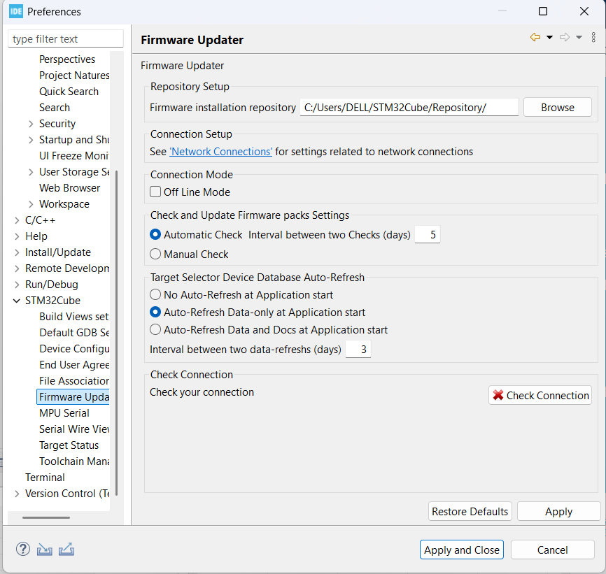

I'm encountering a "network connection failed" error in my Cube IDE. Despite reinstalling the IDE multiple times, the issue persists. As a result, I'm unable to generate the code. Any suggestions on how to resolve this?

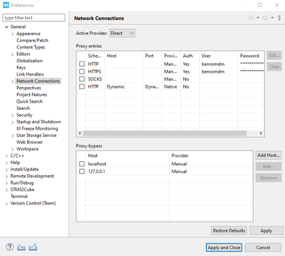

Before checking the connection, you should set the connection parameters for STM32CubeIDE:
Go to [Window]>[Preferences]>[General]>Network connections]
Change [Active provider] to Manual.
Update the proxy entries for HTTP and HTTPS with specific HOST, Port, User, and Password using the [Edit...] button.

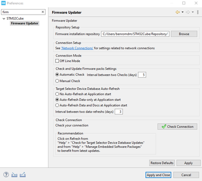

Then, go to [Window]>[Preferences]>[STM32Cube]>[Firmware Updater] and click on the "Check connection" button.

Hello @Jhon_Henry ,
I suggest that you consult your IT Services to provide the HTTP and HTTPS settings.
For the user and password, you set your login session.
You are able also to set Active Provider to Direct in order to login to your ST Account.
