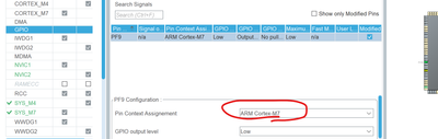

Following the same approach on the H7, for the C7 .ioc file I've similarly made my GPIO assignments, however I can't find any generated code relating to them. In this case main.h is much shorter, lacking any #defines relating to GPIOs. I've searched also for the GPIO pin name (such as PB2) but the only instances I can find are in the ioc file.
Any advice would be much appreciated, my ioc is attached.

You need to assign them to a core in the GPIO tab. Once you do that, they'll appear in the initialization code for that core.

Given that I was configuring the GPIOs in the C7's ioc file it seems strange that I also need to select the core assignment there. Is this to allow a GPIO to be potentially used from either core, with the user then responsible for writing the required GPIO initialisation code, and basically generating the code that MX creates when the assignment is not "free"?

The IOC file you attached controls both cores, doesn't it? It does when I load it. I don't think there is a separate one per core.
