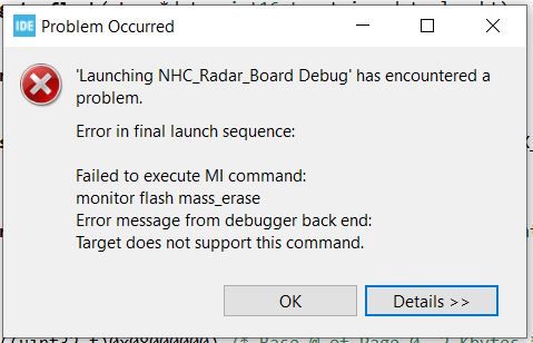

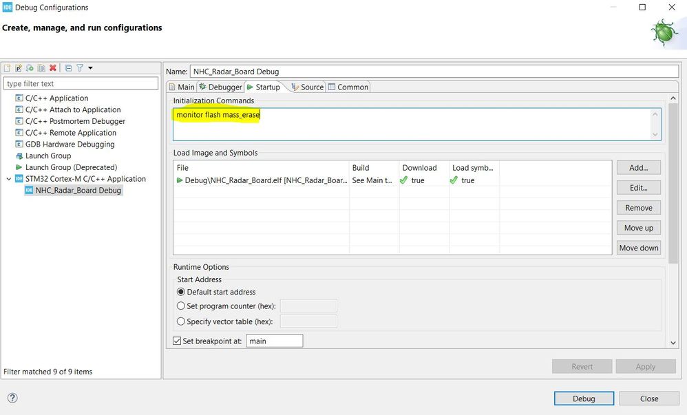

2021-11-06 10:18 AM
I think this works for a ST link debugger connection ; unfortunately not for a Segger Jlink?!
When adding "monitor flash mass_erase" to the debug configuration -> Initialization statup :
I get the following error :
Any suggestions?

2025-01-08 8:55 AM
Try "monitor flash erase" instead. This works for me here with Jlink 8.12 and CubeIDE 1.17.0 (at least when I issue the commands manually)
