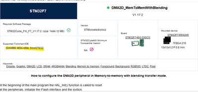

I found the example I'm going to use is not support STM32cubeIDE.
maybe the "nature" problem is because of this issue?

To open this project, you have to follow this user manual. For the difference between CubeMX and IDE. First, CubeMX is a graphical interface designed to just do the first configuration and initialisations for your project. For the CubeIDE, it is just a toolchain that we can use to write code, configure parameters, run compile and debug our code.

by the way, I can build and upload the code to the stm32, but the "nature" problem still there.
every time I import an example, the warning pop up. But it seems no effect on my project(?
2024-08-31 2:14 PM
If your project builds successfully, you can delete from the .project file <natures> section the lines that cause warnings (that contain something ....fr)
