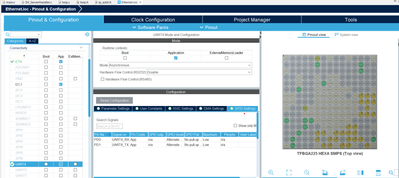

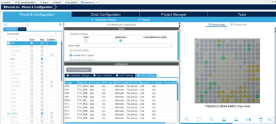

2024-12-22 11:17 PM
Hi @Pavel A. ,
No there is no pin conflict between ETH and UART4.
Here I attached screenshots of both configuration.
