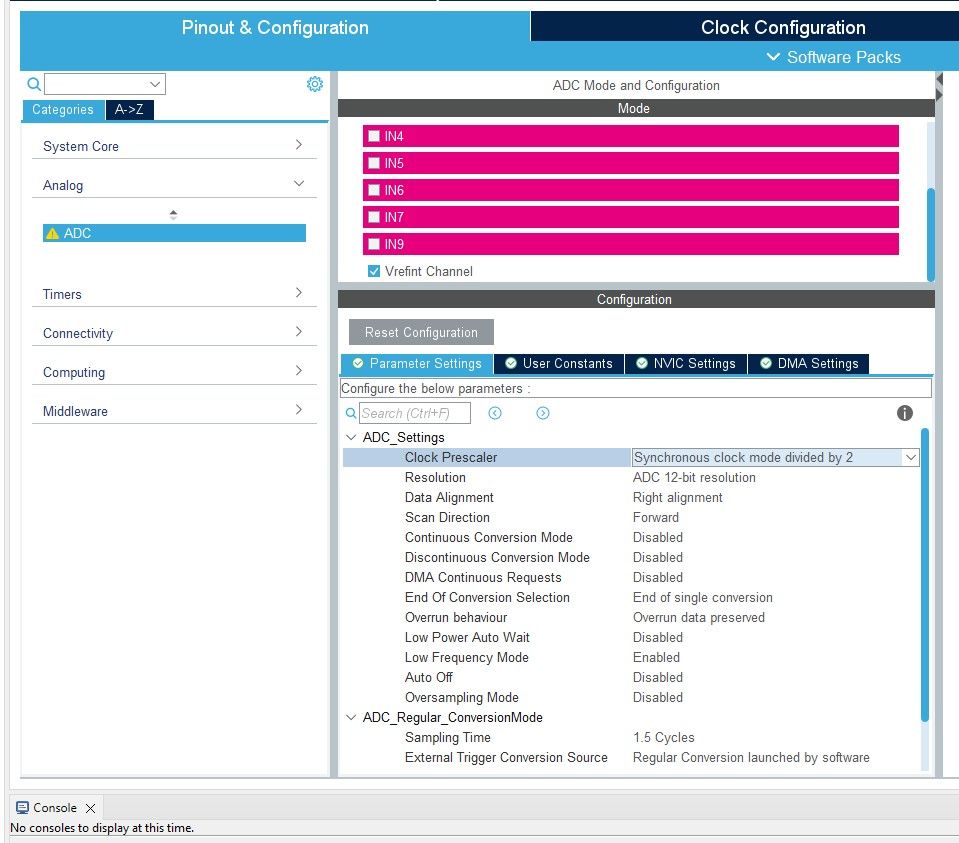

I have a circuit with stm32l010f4 that has no ADC pin available because I am using them as digital GPIO, but I need to measure the battery voltage in my application, my question is if Vrefint can be used to make the measurement. I have already made the configuration of Vrefint in stm32cubeide but it only gives me a value of 1.0693W00000Y8BXSQA3.jpg

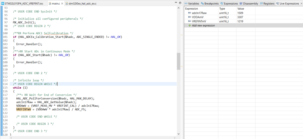

Here my results. Computation of VDDA using ADC_IN17 VREFINT conversion and internal factory calibration.
Live Expression windows:
adcin17Raw = 1509 VREFINT decimal value converted by ADC.
VDDAmV = 3307 The actual VDDA computed in mV
VREFINTmV = 1220 The actual VREFIN in mV
0693W00000Y8BuHQAV.pngI can share the CubeIDE project, Let me know.

hello! i also got adcin17Raw = 1509 VREFINT, i wanted to know what is the formula you use to calculate VDDAmV? i know that in the reference manual there are two formulas. Can you share your code please? i'm also using cubeIde

Hello @jdo (Community Member)
Of course, here the project attached.

i test and this is perfect
