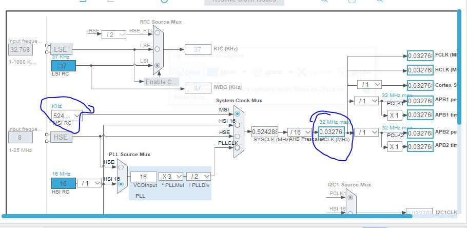

i am using stm32l010f4, i do a test with internal frecuency, why i need use 32.768mhz, but i don´t have external clock on pcb, i do a test with msi rc 524.288 khz, SYSCLK(MHZ): 0.524288, AHB PRESCALER (Here i configure with 512 and compile, i test and the clock work,so i decre the AHB prescaler in 16 and i test and the clock not work.

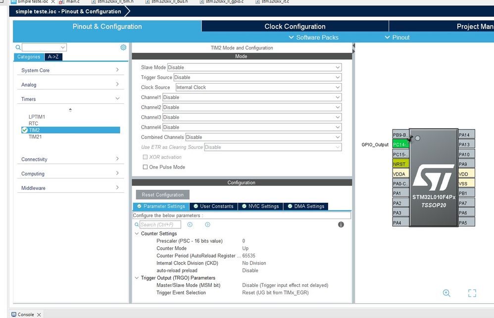

thanks for replying, i am configuring with .ioc using stm32cubeide. now i got the clock to work with 32.768khz, but when i enable timer 2, and compile i test again, then the c

#endif /* USE_FULL_ASSERT */lock doesn't work anymore.

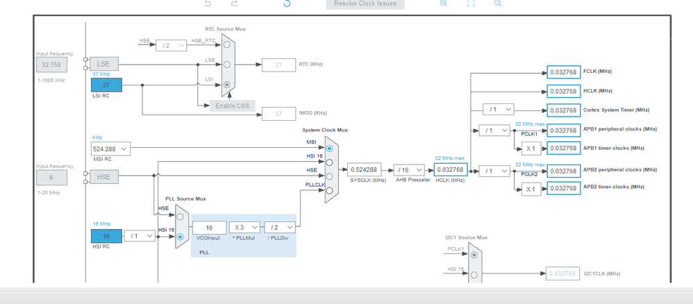

2024-05-06 5:56 AM
"I am setting up the clock for 32.768kHz, but when I compile and test it, it doesn't work. I place a simple counter in the while loop, but it doesn't increment."
my code is:
