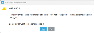

File -> New -> STM32 Project
At this time, I got the following WARNING meesage.
Does anyone know how to solve this issue?

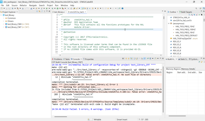

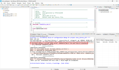

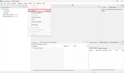

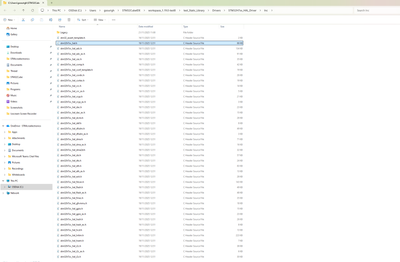

I tried to build the generated project using the following actions.
And then, I got the following errors.
However, this file already exists, as shown in the image below.
Did I make any mistakes in the steps I took to create the library? And how can I resolve these issues?

Hello @jovewu

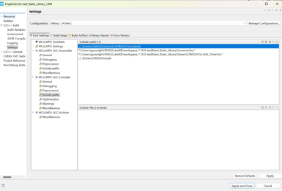

To resolve this issue , please follow those steps :

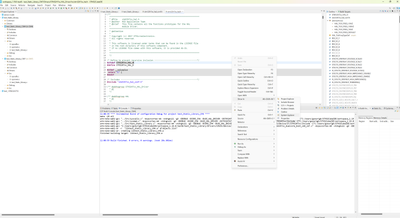

- Open the two files : stm32h7xx_hal_conf.h. and stm32h7xx_hal.h
- Right click on the stm32h7xx_hal.h then select show in option then System Explorer
This will open the path where the file is placed , copy the path
- Right click on the CM4 project --> Properties -->C/C++ Build -->Settings -->MCU/MPU GCC compiler -->include paths : add the copied path --> Apply and close
- Do the same thing for the stm32h7xx_hal_conf.h
- Redo the work for your CM7 project
Then build your two projects : will get 0 Errors 0 warnings
THX
Ghofrane

Hello @jovewu
THX
Ghofrane
2025-11-21 4:31 AM
Hello Ghofrane,
Yes, this solution is feasible.
THX
JoveWu
