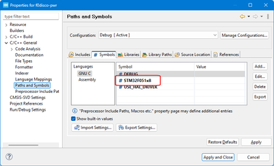

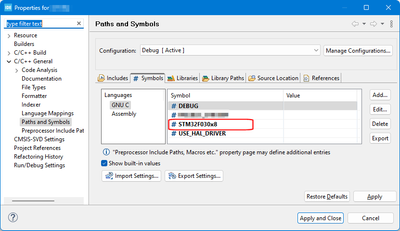

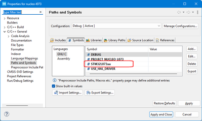

CubeIDE will automatically include a #define for the chip you're using; eg,
So you could use that to create your "family" macro; eg,
