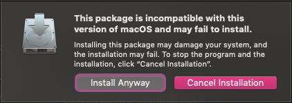

The install for ST-LINK Server fails with an error about it being incompatible and harmful.

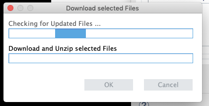

If I selected "New STM32 Project" then the following dialog appears, and just sits there indefinitely. You cannot click on OK or CANCEL and nothing works from now on.

On the "Install Anyway" thing, that's a known issue and is listed in the release note.
As to the check for update macOS bug, there's a ticket for it. You can hopefully use this workaround in the meantime.
Let me know if it works!

2019-06-17 4:17 AM
Thanks. After a while, and a number of re-launches, it just started working.
