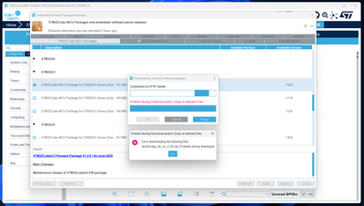

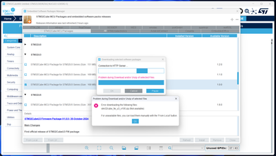

In STM32CubeMx, the MCU-Package versions V1.2.0 and v1.0.0 throw an error when i try to download them :

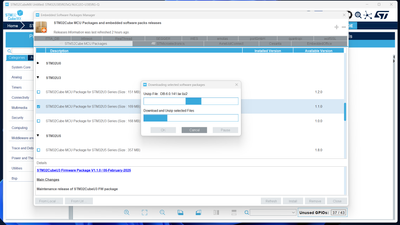

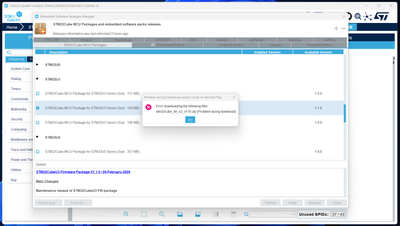

Version 1.1.0 therefore tries to unzip something for some reason and exits after a while with the same error message type:
