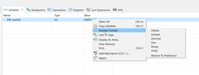

Do someone know how to fix the wrong type format on Live Expression under Debug?
The format is uint16_t which "live expression" understand corretly, but shows signed int.
Please, see the picture attached.
It was right on old CUBE versions...
Regards.

2023-08-14 11:25 PM - edited 2023-08-14 11:32 PM
Right click on your value gives the option, default or decimal. (default is unsigned representation)

Hello @JSILV.2 ,
The issue is not reproduced on the newest STM32CubeIDE version. Could you, please, provide which STM32CubeIDE version and MCU used for this project.

2023-08-15 4:24 PM
Issues, solved.
