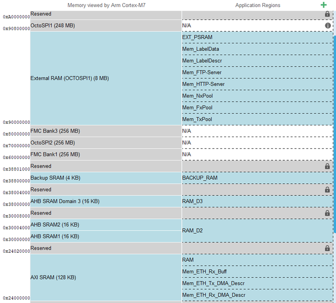

There's a bug in X-CUBE-AZRTOS-H7 V3.3.0, which affects the memory assignment.
I declared the following memory assignment:
This generates the attached "STM32H723ZGTX_FLASH.rar" file. The memory declarations are in the file, but those are not used in the generated code file "app_azure_rtos.c." Not only is it not used for the "Tx_Pool_Buffer" and "Fx_Pool_Buffer" declarations, but it's also wrong for the "NX_Pool_Buffer" declarations.

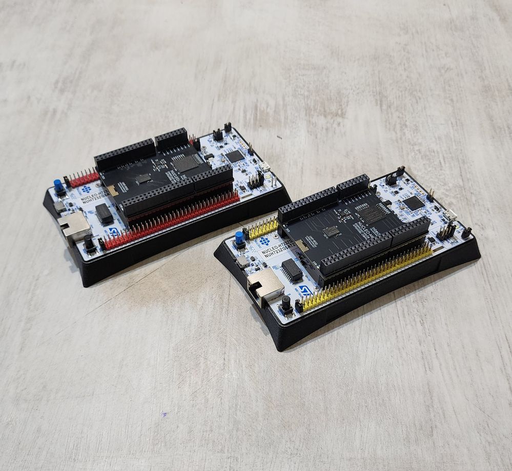

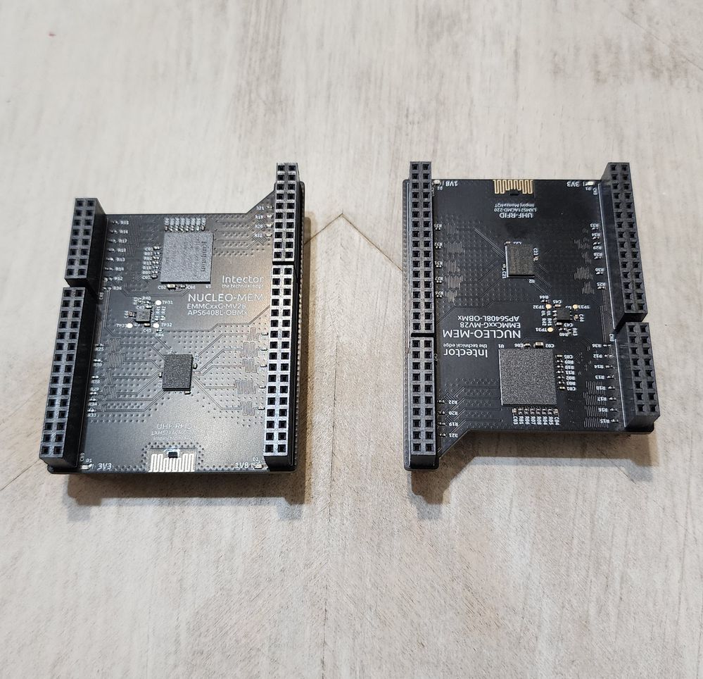

I made these boards containing an eMMC chip with 8 GByte and a PSRAM chip with 8 MByte.
I have some problems. Whenever I address the AZRTOS buffer to 0x90000000, the compiled program can't be downloaded to the board. It gives me the error message that it is outside the available memory. The problem was that the generated code does not reflect the static memory assignment for the AZRTOS buffer. If I assign the buffer manually in the "app_azure_rtos.c." file, the compiled firmware will not flash onto the board with some strange error message. I tried to use the Cube-Programmer to flash the binary FW-File onto the board, but that file is about 2 GByte.
I started over to get the PSRAM to work first and than go from there.
