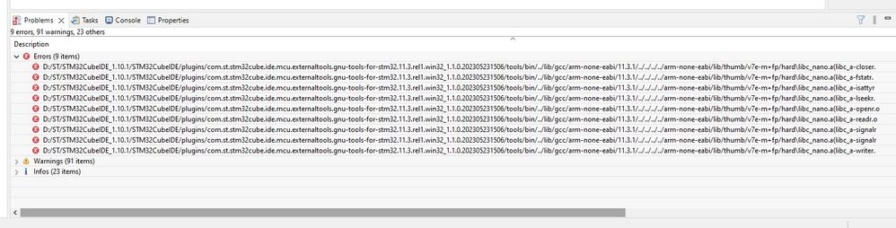

Since updating the Cube IDE last week it's listing 9 link errors on compile related to the MCU tools, nano lib, but if I just compile it again the errors disappear!
Before the update this didn't occur.
If anyone else has this or knows a fix, please let me know.

Hi Rim, so I just finished and it wasn't anything to do with includes, simply by reloading the same toolchain, making no changes, then rebooting the IDE twice, it got back to failing the compile the first time with the same 9 errors, then if compiled directly again, magically with 0 errors! STM IDE is generally a mess IMHO, and needs a serious reworking probably with a new manager who can get the team to locate and fix all these quirks.

The issue is not reproduced with a simple STM32CubeIDE project after update from CubeIDE 1.10.0 to 1.13.1.
But, when I tried with an STM32CubeIDE example for X-CUBE-SBSFU package I have the same behavior that you faced and there are errors related to the link with libc_nano library after update.
To further analyze the issue, could you, please, provide the content of the console view.
Also, it would be helpful to share more information about the project such as, if you have used a specific configuration or a software package.

Hello Robmar.
The problem that is causing the failed build was fixed in CDT (https://github.com/eclipse-cdt/cdt/commit/1b2472faff2028f0323ad5c5eb85565f81b89053) last Friday and should be available in the Eclipse SimRel 2023-09.
The fix will however only be available in STM32CubeIDE after this version has been integrated.
We'll do our best to provide an update as soon as possible according to our roadmap.

Hello Robmar,
We worked to a workaround if needed, please find it :
Go to Windows > Preferences
Open the tab Error Parsers into C/C++ > Build > Settings
Select GNU Linker Error Parser, double click on the pattern for the 1st severity Ignore
Changer :
(.*?):?(\(\.[^\s+]+\+.*\))?:\s*(In function [`'"](.*)['"]:)
to :
(.*?):?(\(\.[^\s+]+\+.*\))?:\s*([Ii]n function [`'"](.*)['"]:)

I've cleaned our project, made the edit, compiled and bingo, the 9 errors are not being listed.
Can you explain why this fix is needed, what it does, and whether it will be rolled out in the next CubeIDE update?
